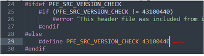

Daniel-Aguirre
Thanks for your feedback.
Regarding the PFE Version, the following is provided under the "pfe_cbus.h" file:
We don't fully understand what version you are trying to access.
Please, let us know.

Daniel-Aguirre
Since this is related to the PFE registers, and due to PFE IP license limitation, PFE register description cannot be shared.
Since the routine is available inside the PFE drivers that NXP provides, and no modification should be done, then the version should be the one you are seeing.
