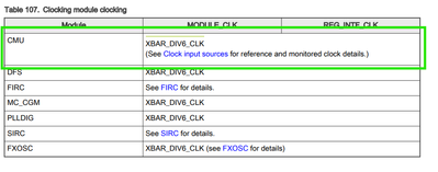

In the process of using CMU module, I encountered the following two problems
1. In the formula for calculating the minimum value of RCCR[REF_CNT], one parameter is fbus_clock. How to determine the value of fbus_clock?

Hello @zhucc
Thanks a lot for your patience. About the meaning/value of Fbus_clock, it is equivalent to the "module clock", you can see this in table 107 of the reference manual [page 581, S32G2 Reference Manual, Rev. 8, February 2024]:

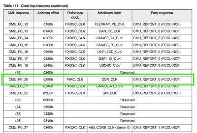

you can double check it in the generated code of a project, for instance in the example Mcu_Example_S32G274A_M7, file  RTD\src\Clock_Ip_Data.c, using the DDR_CLK as example, since all the elements of this array use XBAR_DIV6_CLK: 
Therefore the frequency of the Fbus_clock, in this case, will be 4MHz:

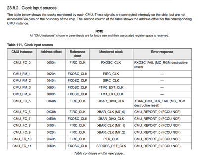

Please also check section 23.8.2 [page 856 and onwards, S32G2 Reference Manual, Rev. 8, February 2024]:
Let me know if this information answers your question.
