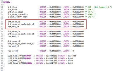

Open the can2can DS project, modify the LD file to match the space occupied by "IPCF_Sample multi_instance S32G274A_M7-0", compile and add IVT and other information, burn QSPI, and I caught the can signal on the llce_can line;
I used the can2can program to replace IPCF_Samplemulti_instance S32G274A_M7-0 and started can2can through bootloader, but I couldn't capture the relevant signal on the can line.

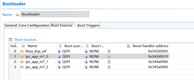

The following figure shows the jump information when burning can2can separately, compared to the jump information when bootloader starts

2. Have you changed the addresses of Reset_Handler and int_sram_c0 in the Bootloader? The addresses of CAN2CAN program need to be changed to those in CAN2CAN program before CAN2CAN program can be started.

2. I modified ResetHandler and int_stram_c0 on the bootloader. The following image shows the ld file of my can2can;
