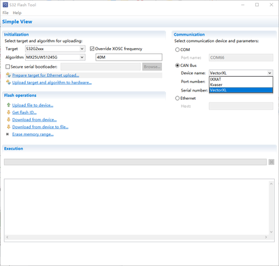

Is there documentation describing how to download it by CAN? I only know that downloading via UART is using S32FlashTool

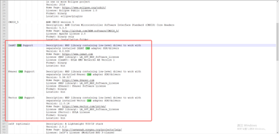

I found some information about CAN download. Do you only support CAN devices from these three manufacturers (VectorXL Kvaser IXXAT)?
2,938 Views
Daniel-Aguirre
For what it is provided under the S32 Flash Tool User Guide, those 3 "CAN device name" are the ones provided.
