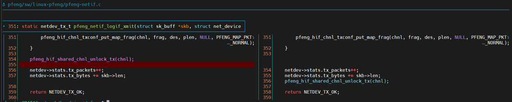

yeah,I meet the same issue.I think we should modify like this
bugfixbugfix

Reading your log, the actual fix should be as follows:
diff --git a/sw/qnx_workspace/linux-pfeng/pfeng-netif.c b/sw/qnx_workspace/linux-pfeng/pfeng-netif.c
index 15d7a4656..a283c27ee 100644
--- a/sw/qnx_workspace/linux-pfeng/pfeng-netif.c
+++ b/sw/qnx_workspace/linux-pfeng/pfeng-netif.c
@@ -226,7 +226,7 @@ static netdev_tx_t pfeng_netif_logif_xmit(struct sk_buff *skb, struct net_device
        u32 nfrags = skb_shinfo(skb)->nr_frags;
        struct pfeng_hif_chnl *chnl;
        pfe_ct_hif_tx_hdr_t *tx_hdr;
-       unsigned int plen;
+       unsigned int plen, pkt_len;
        dma_addr_t dma;
        int f, i = 1;
        errno_t ret;
@@ -331,6 +331,8 @@ static netdev_tx_t pfeng_netif_logif_xmit(struct sk_buff *skb, struct net_device
        /* Software tx time stamp */
        skb_tx_timestamp(skb);
+       pkt_len = skb->len;
        /* Put linear part */
        ret = pfe_hif_chnl_tx(chnl->priv, (void *)dma, skb->data, plen, !nfrags);
        if (unlikely(EOK != ret)) {
@@ -366,7 +368,7 @@ static netdev_tx_t pfeng_netif_logif_xmit(struct sk_buff *skb, struct net_device
        pfeng_hif_shared_chnl_unlock_tx(chnl);
        netdev->stats.tx_packets++;
-       netdev->stats.tx_bytes += skb->len;
+       netdev->stats.tx_bytes += pkt_len;
       return NETDEV_TX_OK;
