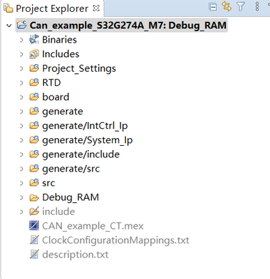

Hi , All I use s32g274ardb2 board to test the can drivers with M7 core

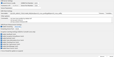

I use S32 Design Studio for S32 Platform 3.4 to import can example and debug the project using PE debugger in  s32g274ardb2 board , then it can run and debug it.

So I doubt that it has something wrong with the previous debugging code with m7 kernel and effect the A53 boot.

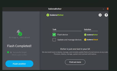

For reflashing the SD card, you can use an image flasher tool (like Etcher) which reformats your SD card and creates the needed partitions. The file you need to input the program is the one located at:
"binaries_auto_linux_bsp33.0_s32g2_pfe\s32g274ardb2\fsl-image-auto-s32g274ardb2.sdcard"

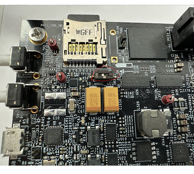

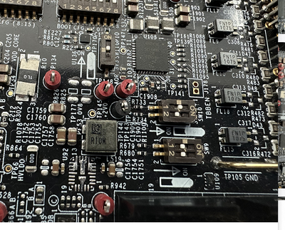

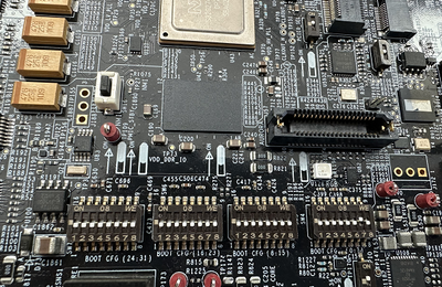

As for the settings, we may recommend double checking: SW10, SW3 and SW4, to validate the positions, since it is common to change them due to development reasons. For the boot configurations, you could also look into the RDB2 User Guide, available under the RDB2 product page, S32G2 Vehicle Networking Reference Design | NXP Semiconductors) to confirm your setup.

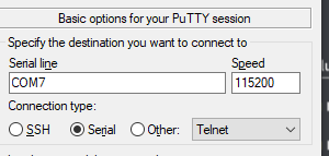

Once the SD is flashed and the RDB2 is configured to boot from SD, you should get an output from UART0 under the following configuration on your serial terminal (COM number may vary):

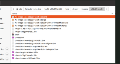

I download the Etcher and reformats my  SD card, I put fsl-image-auto-s32g274ardb2.sdcard into the Etcher, and writing image into SD card.
Ada_Lovelace_0-1683170706970.pngAda_Lovelace_0-1683170706970.pngAda_Lovelace_1-1683170719836.pngAda_Lovelace_1-1683170719836.png
Then I set the switch settings:SW9 SW10 SW3 SW4 SW5 SW6 SW7
Ada_Lovelace_2-1683170769123.pngAda_Lovelace_2-1683170769123.pngAda_Lovelace_3-1683170789150.pngAda_Lovelace_3-1683170789150.pngAda_Lovelace_4-1683170805972.pngAda_Lovelace_4-1683170805972.png

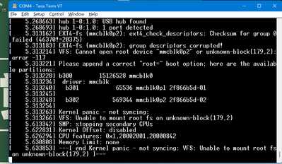

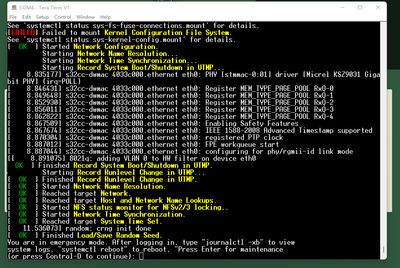

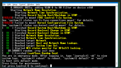

Then I try to uboot from  SD card. but it reports erros all the same.
I upload the UART0 log, I do not know what it's wrong with it.
I test many times uboot from SD card , it always work. But I do not know why it do not work after debugging the application from M7 core.
Please help me how to fix it or can you provide me fsl-image-auto-s32g274ardb2.sdcard? I will try it again, but I think it is not the problem about the SD card , I think it is something wrong with the board.

Daniel-Aguirre
Thanks for your feedback. For the log you have shared, we see you are using BSP36, and that several modules are missing (i.e. pfeng and SJA1110 FW, they should not be the cause of the issue). We understand that you are not using a provided NXP BSP image, but it seems that you are generating it yourself.
Ca you help us verify with the provided NXP BSP 33.0 image to confirm the behavior is constant? Also, can you help us confirm if using other SD cards bring the same problem?

Ada_Lovelace
I  try NXP BSP 33.0 image, it can uboot successfully.
So I  delete the directory: build_s32g274ardb2,the  I use command: ./sources/meta-alb/scripts/host-prepare.sh  and  . nxp-setup-alb.sh -m s32g274ardb2 and writing image to SD card , it can boot well.
But I have one problem,  directory:build_s32g274ardb2 has no work_shared directory after I rebuild it, can I miss some steps ?  Can you tell me the right streps to rebuild it?
