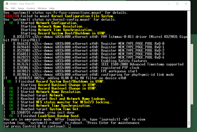

Hi , All I use s32g274ardb2 board to test the can drivers with M7 core
I use S32 Design Studio for S32 Platform 3.4 to import can example and debug the project using PE debugger in  s32g274ardb2 board , then it can run and debug it.
Now I want  to run LINUX BSP in A53 core , so  I writing the image into the SD card and set the switch setting.
But it can not uboot successfully.
I use the old and new image and dtb (Tested and uboot successfully before debug the code ), now it all reports errors.
doubt the image or SD card has problem, so I change it , it also failed. The board settings do not change.
So I doubt that it has something wrong with the previous debugging code with m7 kernel and effect the A53 boot.
Please help me to find out the problem, thank you.

I download the Etcher and reformats my  SD card, I put fsl-image-auto-s32g274ardb2.sdcard into the Etcher, and writing image into SD card.
Then I set the switch settings:SW9 SW10 SW3 SW4 SW5 SW6 SW7
Ada_Lovelace_2-1683170769123.pngAda_Lovelace_3-1683170789150.pngAda_Lovelace_4-1683170805972.png
Then I try to uboot from  SD card. but it reports erros all the same.
I upload the UART0 log, I do not know what it's wrong with it.
I test many times uboot from SD card , it always work. But I do not know why it do not work after debugging the application from M7 core.
Please help me how to fix it or can you provide me fsl-image-auto-s32g274ardb2.sdcard? I will try it again, but I think it is not the problem about the SD card , I think it is something wrong with the board.

Thanks for your feedback. For the log you have shared, we see you are using BSP36, and that several modules are missing (i.e. pfeng and SJA1110 FW, they should not be the cause of the issue). We understand that you are not using a provided NXP BSP image, but it seems that you are generating it yourself.
Ca you help us verify with the provided NXP BSP 33.0 image to confirm the behavior is constant? Also, can you help us confirm if using other SD cards bring the same problem?

Ada_Lovelace
I  try NXP BSP 33.0 image, it can uboot successfully.
So I  delete the directory: build_s32g274ardb2,the  I use command: ./sources/meta-alb/scripts/host-prepare.sh  and  . nxp-setup-alb.sh -m s32g274ardb2 and writing image to SD card , it can boot well.
But I have one problem,  directory:build_s32g274ardb2 has no work_shared directory after I rebuild it, can I miss some steps ?  Can you tell me the right streps to rebuild it?
