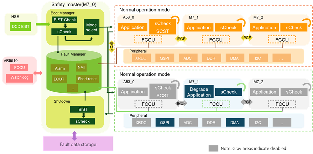

Most customers (Valeo, Conti, Ford, ZF) are interested in integrating SAF into their projects. However, they have encountered several integration challenges, such as link file modifications, module configurations, and other related issues. Additionally, the SAF demo released by the software team only enabled part of sBoot and sCheck test cases.  And part of features are not implemented, such as NVM read/write, test result exchange between different cores. Therefore, this full enablement demo aims to address these gaps by walking through the configuration of all SAF modules and providing a comprehensive demo that covers the entire SAF framework.
The following diagram shows the demo architecture:
For details about the full demo features, please refer to the attached release notes.
