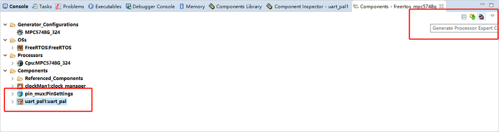

Hi , I am using S32DS for develop on MPC5748G and I want to integrate uart_pal_mpc5748g to freertos_mpc5748g , but failed .freertos_mpc5748g function is OK, but uart function is not of work . the step what I did as below:

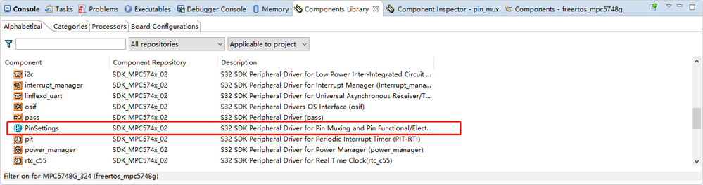

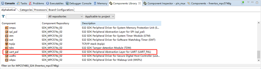

1, add uart_pal and pinsetting  components into freertos_mpc5748g sample code

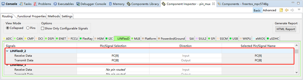

2,config uart_pal and pinsetting component as below:
3,generated code as below;

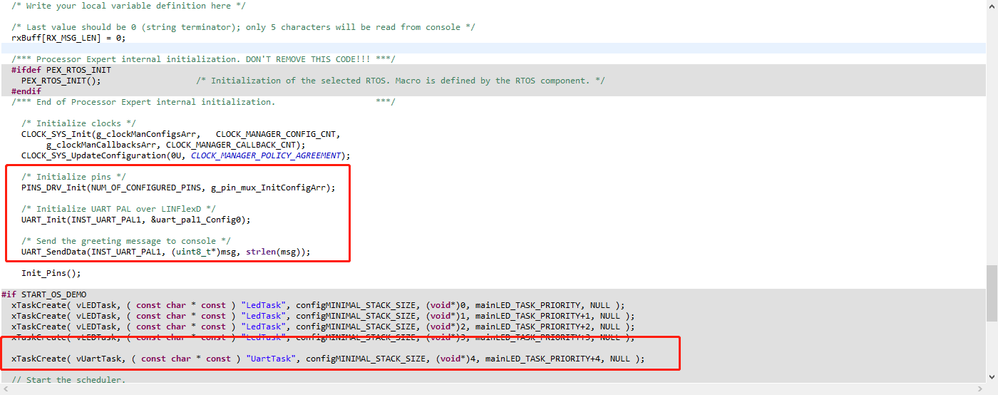

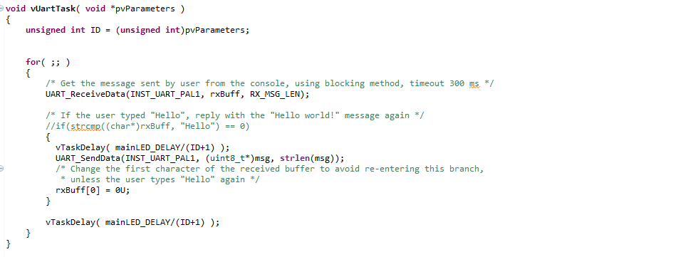

4,add uart function into freertos_mpc5748g sample code as below:
5,compile and debug :
  it can run into vUartTask ,but uart function is not OK----can not send data and receive data
so why uart pal can not work ?

My first hunch would be the pin setup; on MPC5748G the linflexd tx pins are not driven to the UART idle state by the controller, so in order to get accurate UART messages in the console you need to manually enable Pull-up function for the LINFLEXD tx pin. This can be done from PinSettings component, "Functional Properties" tab.
If this doesn't solve the issue, please attach the project so I can take a closer look. From what I see here it should be fine.
