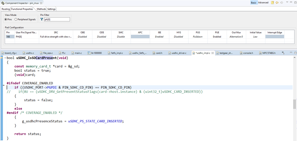

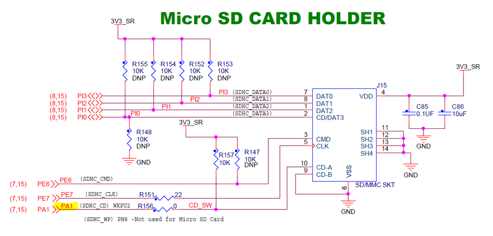

dany_amsalem
I had some some progress in this issue
it appears that card presence DAT3 doesn't work, moreover, it stuck sometimes in uSDHC_IsSDCardPresent() function. this issue fixed after
changing card presence gpio into the other option CD_SW PA1 GPIO. and use other dirty code to read PA1 in uSDHC_IsSDCardPresent().
see below pictures.
another issue I have now with this module refer to power supply sourcing, it works just fine with the MicroUSB  and fails with the 12V source (jumpers changed accordingly to each source). digging in , it looks like that transfer function fails in timeout after semaphore timeout expired in uSDHC_DRV_TransferBlocking() function.
