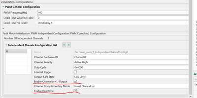

i have a quesiton, if want to generate waveform like this,
i see there have dead time enable, can the dead time can set longer time, is there have parameter  set ?
another questions, it seems only Adjacent channel(n and n+1) can set the dead time,
does ch0 and ch7 or some other random channel  combination with dead time set ?

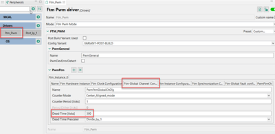

_Leo_
In S32 Design Studio for S32 Platform v.3.5 and RTD for S32K1 and S32M24x version 2.0.0 the parameter to set the Dead Time ticks is in the following tab:
On the other hand, the deadtime insertion is only available for each complementary pair, since its purpose is to ensures that no two complementary signals (channels (n) and (n+1)) drive the active state at the same time.
I share with you an attached sample code for the above mentioned software installation.
Hope it helps you.
Have a nice day!

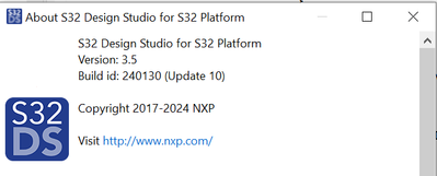

i am using 3.5, there is no deadtime paramter setting
i also compile your project share, there lots of error, maybe miss some packages ?

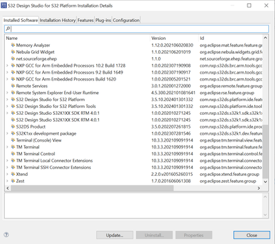

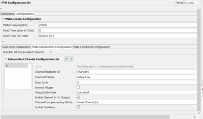

_Leo_
Hi again,
Seems that you are using another RTD, demo works with this setup:

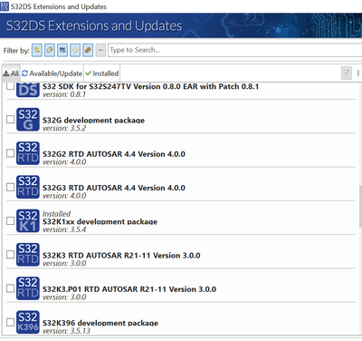

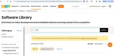

alice_th
with my tool i can't find the package which you show, only autosar have
2,415 Views
alice_th
@_Leo_
also i search in web, i didn't find the package you mention
