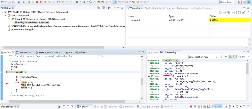

I just creating a project using S32DS version2.1, using SDK3.0.0, board: DEVKIT MPC5744P. And my program is easy. Show below:
main()
uint32_t counter= 0;
initBoard();//do some clock and GPIO initialize
for(;;){
    counter++;
    if(counter>100000)
         counter = 0;
         PINS_DRV_TogglePins(PTC, 1<<13);
My question is when i set a breakpoint at  count  = 0  and debug it , the program won't stop at breakpoint at all, even i can see the LED is flashing. Dose anyone have same problem? Thanks!捕获.PNG

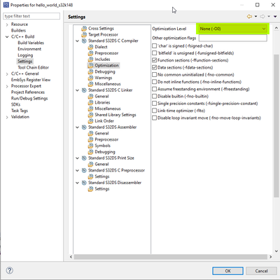

jiri_kral
 Do you  have optimization level set to none?
Jiri

mayao999
Hi, Jiri
Thanks for your help, the method you provided is right, I use level 1 optimization. Change to none works!!
