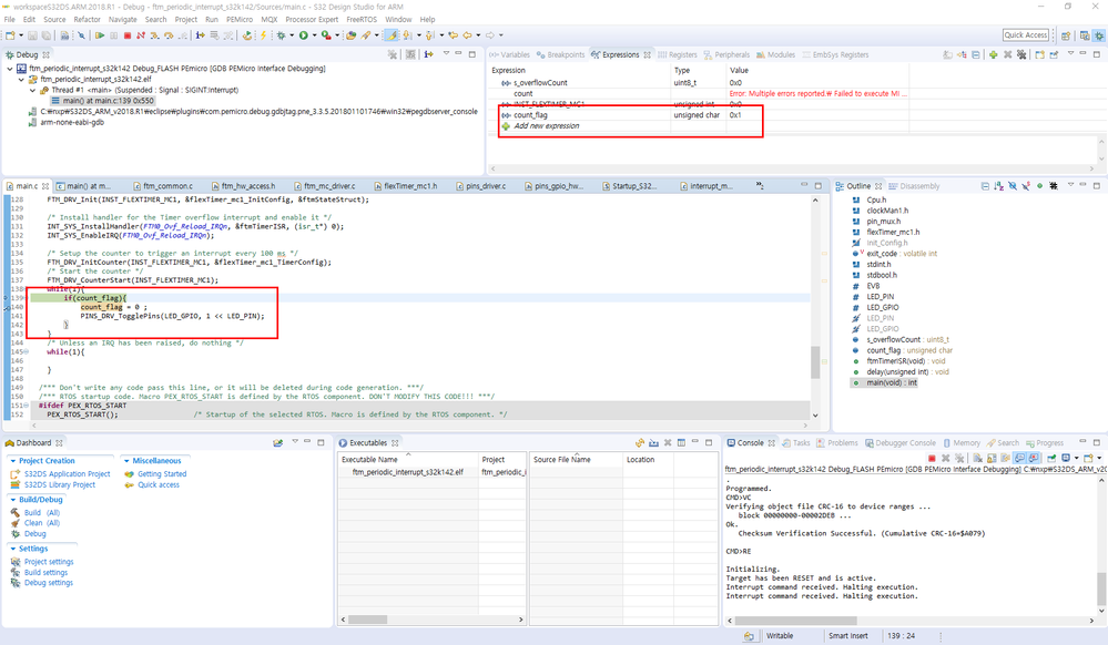

Hi jtpark,
Please select None(-O0) for Optimization Level.

Robin_Shen
Break point at count_flag will stop the debug. You can see the count_flag=1.
I directly copied the entire main.c to the ftm_periodic_interrupt_s32k142 project and test it on S32K142EVB.
