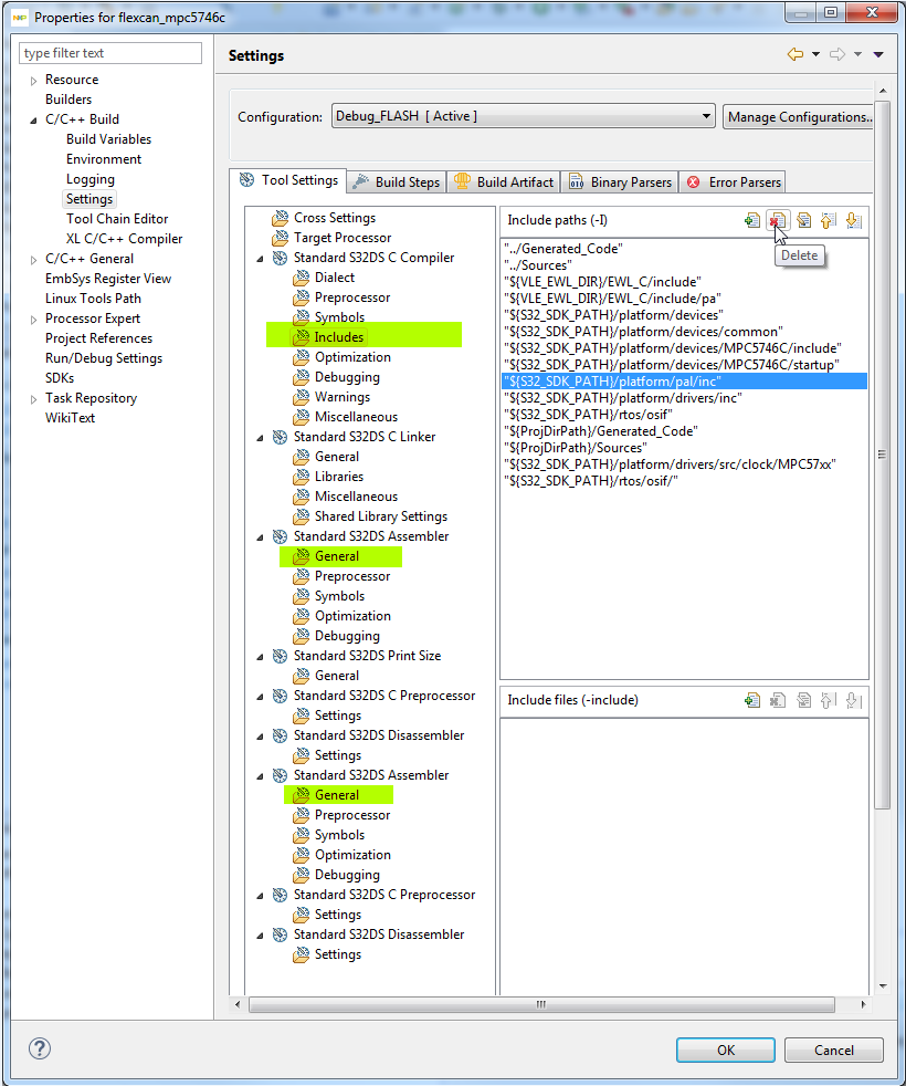

Hello, i'm trying to import from an example project (flexcan_mpc5748g) using the SDK for 5847G. it seems i would need to do two extra steps before i can compile: 1, attach the SDK after import is completed; 2, generate code from ProcExpert.
this seems to work if i try to build right after the code gen from procExpert except a few warnings about non-existance path in the SDK, for example:
Description Resource Path Location Type
Invalid project path: Include path not found (C:\NXP\S32DS_Power_v1.2\S32DS\S32_SDK_MPC574xx_EAR_0.8.1\platform\pal\inc). flexcan_mpc5748g pathentry Path Entry Problem
Invalid project path: Missing project folder or file: \flexcan_mpc5748g\MPC5748G_SDK_Z4_0_GCC for Source path. flexcan_mpc5748g pathentry Path Entry Problem
while i was trying to follow the link, the mentioned pal\inc path indeed does not exist. while i was exploring around the generated sdk code (note this is after the .elf has been generated for the project), some code from the sdk starts to show red marks complaining "type bool could not be resolved". for example, in the clock_manager.c

SDK guys updated little bit directory structure and forgot update some examples. In next release will be path removed. You can remove the include path by yourself from greened out options in project properties:

thanks for report - I can reproduce the behavior. So - about your questions:
When you switch back from 89/90 dialect to 99 dialect - you can see errors about bool type. But if you check the console output - the .elf file is properly generated. The false-positive errors are caused by Eclipse Indexer. You can right click on project -> Index -> Rebuild and the bool "errors" will disappear.
2. Yes - in 89/90 dialect is not bool type present and switching back to C99 without Index rebuild shows errors related to bool type. But project itself is compiled successfully.
Jiri

can you check the missing directory warning as well? it's a warning only but every time i click on the SDK menu there is a popup trying to add those paths back. our project would require 'warning free' from the compiler.
