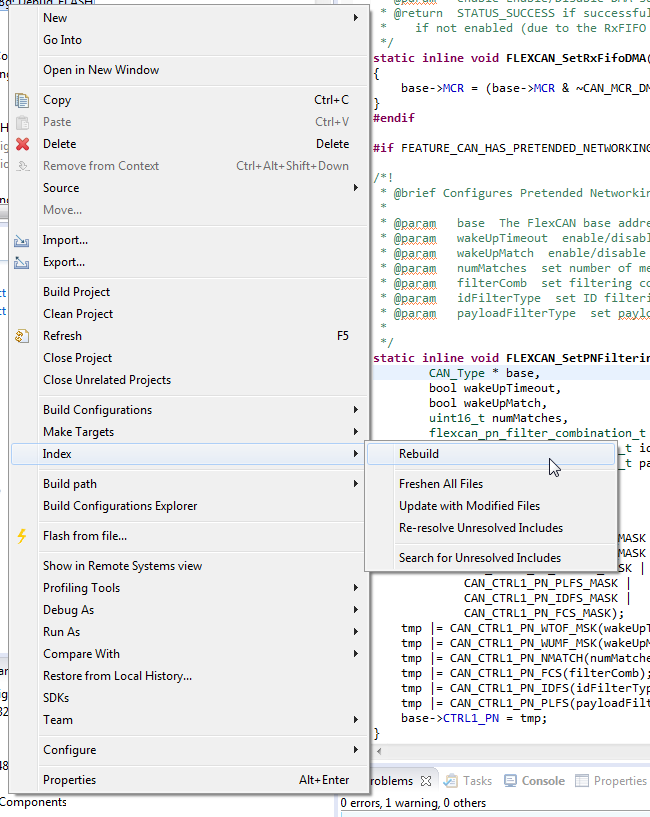

Hello, i'm trying to import from an example project (flexcan_mpc5748g) using the SDK for 5847G. it seems i would need to do two extra steps before i can compile: 1, attach the SDK after import is completed; 2, generate code from ProcExpert.

while i was trying to follow the link, the mentioned pal\inc path indeed does not exist. while i was exploring around the generated sdk code (note this is after the .elf has been generated for the project), some code from the sdk starts to show red marks complaining "type bool could not be resolved". for example, in the clock_manager.c

so my question is two folds: 1, why i could build the project in the first place and generated the proj.elf? was there precompiled files from proc expert being copied to my proj folder? 2, what was the compiler settings or language settings that causes the bool type error? C99 defines bool but not C89/90 i guess.

thanks for report - I can reproduce the behavior. So - about your questions:
When you switch back from 89/90 dialect to 99 dialect - you can see errors about bool type. But if you check the console output - the .elf file is properly generated. The false-positive errors are caused by Eclipse Indexer. You can right click on project -> Index -> Rebuild and the bool "errors" will disappear.
2. Yes - in 89/90 dialect is not bool type present and switching back to C99 without Index rebuild shows errors related to bool type. But project itself is compiled successfully.
