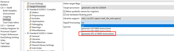

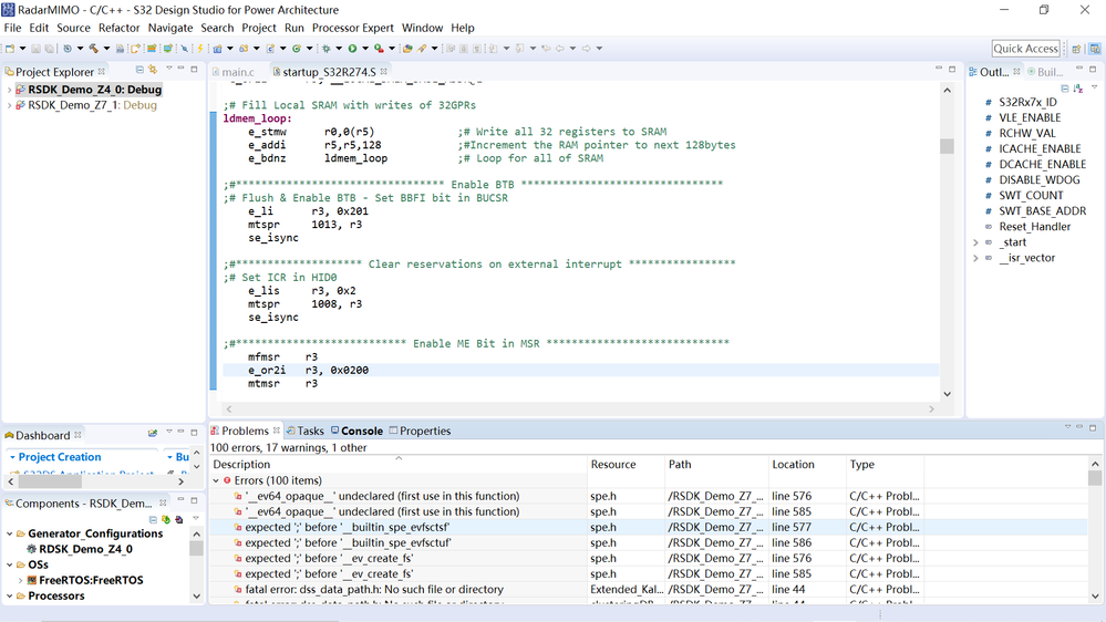

I need to enable SPE in the core of S32R274 Z7-1 to speed up some algorithms. The steps are as follows:
1
2
3 add files
#include "spe.h"
#include "spe2.h"
After I finished these operations, there were a lot of errors in the compilation project。Is there something wrong?

All you need to do is to enable them in S32DS:

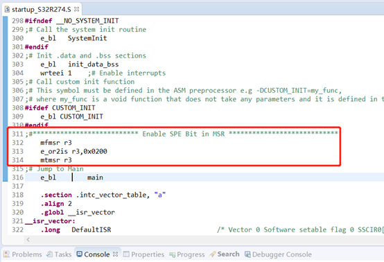

The settings you reply to are the default settings,After I add spe.h there are still a lot of errors C:/NXP/S32DS_Power_v2.1/S32DS/build_tools/e200_ewl2/EWL_C/include/pa/spe.h:830:30: error: unknown type name '__ev64_opaque__'
2,798件の閲覧回数
longfeiwang
problem  has been  solved   THKS
