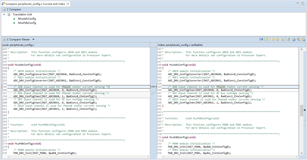

Hello, I'm trying to modify the code from the official motor control demo.
The original demo uses 3 ADC channels, and I want to add an additional channel. Please see the table below.
original  expected
pinadc channelphysical signalpinadc channelphysical signal
   PTA6ADC0_SE2i_ph_c
PTB1ADC1_SE15i_ph_bPTB1ADC1_SE15i_ph_b
PTB0ADC0_SE4i_ph_aPTB0ADC0_SE4i_ph_a
PTB12ADC1_SE7v_busPTB12ADC1_SE7v_bus
Here is what I have changed in processor expert.
add configuration for adc0_se2
add the associated pdb configuration
modify the adc peripheral configuration
modify the pdb peripheral configuration
You can find the archive file of the project in the attachment.
When I flash the binary file to the official demo kit, an error occurs, the software falls into  the default ISR.
Can anyone helps to find the root cause?
By the way, I have disabled the adc interleave and the test result is ok, the motor can run.

Hi@Jimny
     I double checked your configuration and found no problem, I suggest that you can try single-step debugging first, locate the step where the exception occurred, send me a screenshot of the picture, and then I'll check if there is anything I haven't considered arrive.
    You can also refer to the ADC pre-trigger configuration of the MCSPTE1AK144_BLDC_6Step,this routine can also be found in your install path,
