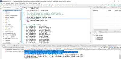

when i test flash_partitioning_s32k144 example , i find HardFault.
could you help to check it.
Connection from "127.0.0.1" via 127.0.0.1. Connection from port "63674" to 6224 Connection from "127.0.0.1" via 127.0.0.1. Connection from port "63675" to 7224 Searching for Kernel Symbols... rsp_qC - qSymbol: 5F74785F7468726561645F63757272656E745F707472 _tx_thread_current_ptr not found. ThreadX analysis not enabled. rsp_qC - qSymbol: 707843757272656E74544342 pxCurrentTCB not found. FreeRTOS analysis not enabled. UsageFault: An instruction executed with an invalid EPSR.T or EPSR.IT field. HardFault: A fault has been escalated to a hard fault.

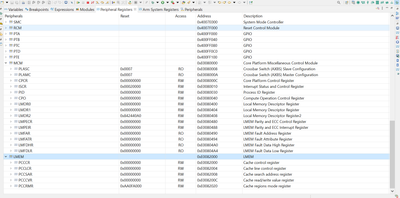

Could you try disabling interrupts before launching erase operations?
Also, could you share what you see in the core registers? It could provide enough details to find the source of bus/hard fault.

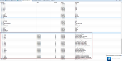

alice_thanks
i didn't see that register you show, see below,
