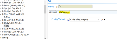

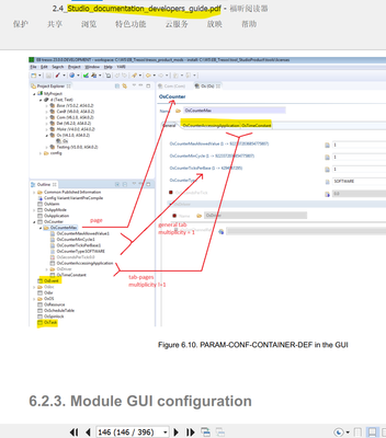

When I was reading the manual 2.4_Studio_documentation_developers_guide and planning to build a configuration project according to Os_TS_T40D2M10I0R0, I chose the Os module. I found that the Os module only has OsCounter.
How can I get the task, event and other configurations in the manual, and where can I download the Os (4.1.0 AS4.0.2) in the manual?

Hi decoski,
In the MCAL package and RTD package, the Os module is a stub.
To use Os, you can download the OS packages at this link:
https://are.nxp.com/FlexNetCatalog.aspx
Or you can contact EB Elektrobit to get support for this issue.
Dan

I discussed your issue with my colleagues. Sorry because I provided you the website is accessible by NXP employees only.
The last version of the Autosar OS 4.0 is available through search https://www.nxp.com/search?keyword=+AUTOSAR+4.0+OS+%28QM%29+for+S32K14x&start=0
The direct download link is then  AUTOSAR 4.0 OS (QM) for S32K14x
