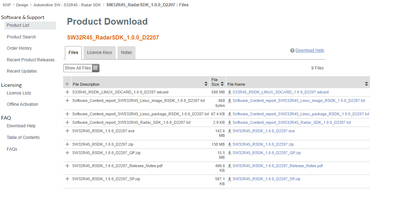

Most of the recipes fetch the source code as well, but in case of the Radar SDK, it only builds the .ko, libraries and installs them into the rootfs. The recipes into  meta-rsdk do not fetch the source code of the RSDK.
To get the source code of the RSDK you have to sign-in into your NXP account. Go to Software Licensing and Support-> Software Accounts->Automotive SW S32R45 Radar SDK.
You should see something like this:
