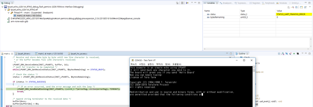

I use S32 DS for ARM.2018.R1 and SDK EAR v0.8.6 and RTM v2.0.0.
I found something strange during UART SAMPLE code analysis.

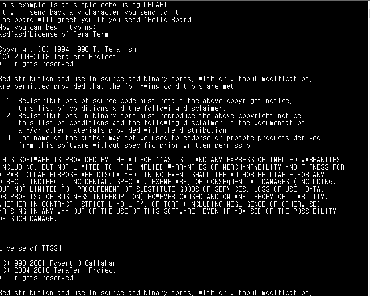

The lpuart samp of EAR0.8.6 sdk and the lpuart sample of RTM2.0.0sdk have been modified to echo one word at a time.
And I sent the attached file and confirmed the uart message.
The sample of EAR0.8.6 sdk showed the contents of the file normally.
However, the RTM 2.0.0 sdk was unable to display the contents of the file due to a frame error.
What is the difference between the RTM 2.0.0 sdk and the EAR 0.8.6 sdk in the UART function?
What should I do to correct the error in the RTM 2.0.0 sdk?
I attached the code and file.
RTM 2.0.0 result
EAR0.8.6 result

Indeed, starting from SDK BETA 1.9.0 release, we slightly changed the implementation of LPUART driver, for consistency reasons.
Briefly, there are two main changes:
 1) the Rx/Tx logic is now only enabled when a reception/transmission is in progress (as opposed to the old implementation where rx and tx were enabled whenever the driver was initialized); this allows a better management of the rx messages especially, since junk data on the line does not affect the driver state, unless a reception is launched by the application. For this reason, receiving a string in multiple calls to ReceiveData for each byte doesn't work anymore, since disabling/reenabling the receiver takes too long and some bytes are missed eventually. This usecase can now be implemented using callbacks.
  2) the callback approach - callbacks are now called only when the transfer is complete and not after each byte, as they used to be; this makes more sense from the application perspective and it's also easier to use. We also added setBuffer functions for both tx and rx; these can be called from the callback to refresh the data buffer, in order to implement a continuous transfer usecase.
We updated the LPUART example and documentation to highlight these changes. Please refer to the doxygen documentation in the RTM 2.0.0 release and also try to use the latest example.
Hope this clarifies your question. Please reply if you need further details, I'll be happy to assist you!
Vlad

Sorry for the delayed response! The example in RTM considers a maximum input buffer of 256 characters. I think that's why it doesn't work, the text you feed from the console is way bigger and it overflows somewhere.
Could you please try increasing the BUFFER_SIZE macro defined in main.c file and check if works?

kbj
This is the result of modifying the example included in RTM2.0.0 for the purpose I need.
As a result, the above problem occurred in RTM 2.0.0.
In EAR0.8.6, it works well and RTM2.0.0 has a problem, so I asked about the project.
