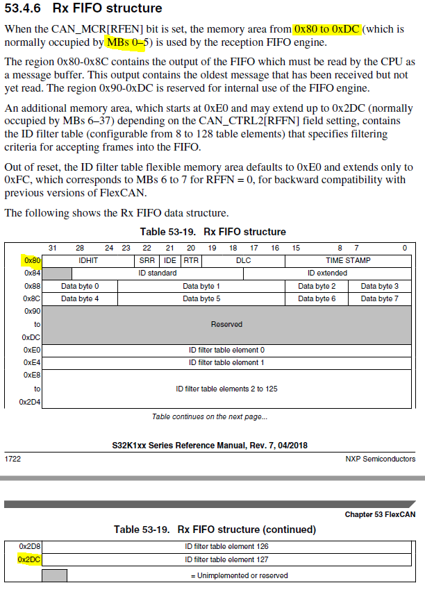

Simple by reading carefully what I previous said "The fifo use MB0 to MB6 to store messages" So mb_idx 0-5 are not used in process of tx are exclusively in rx. the mb1 to mb5 can be used in some conditions as tx but I don't recommend it and the driver wasn't designed to be allowed. After the receiving MBs are the FilterID space occupied based on how many you have configured in your case will be 6-7Mbs so next available MB will be 8 that can be used in TX. For this infos read the RM for the chip on the FLexCAN peripheral will find the message buffer structure to understand how the things work. And which filters are affected by individual or global mask based on numbers of filter configured you will find a table under RFFN bitfield of CAN_CTRL2 register in RM.
You receive MB0 busy because all time is used in RX fifo and is armed for receiving, and MB1 actual will try to set next a mb designed to be used by RxFIFO and for this you will get out_of range status.

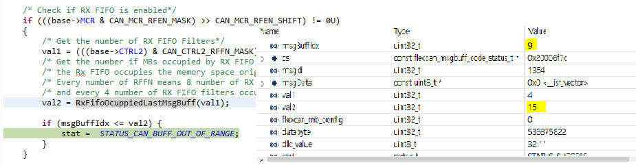

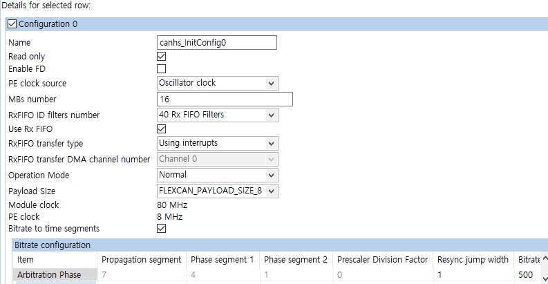

kbj
Dear Nan
Thanks for your support.
I use 32 RX ID.
In my code, MB7 ~ MB15 return STATUS_CAN_BUFF_OUT_OF_RANGE '0x300'.
Return function and point is below.
Please check it and let me know how to resolve it.

alexandrunan
To work with your configuration because You set 40 Filters ID and I supposed as only 8 as default the problem change because occupy more MBs for filters ID. Here is a table that correlates the size of filters ID and the space used as MBs for them. pastedImage_2.png
So you need to increase the MBs No from configuration because you use all of them for RxFIFO. Then the next available MBs Index will be 16, that can be used as Tx. I hope this clear your scenario.
