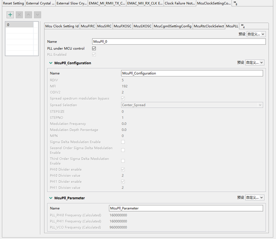

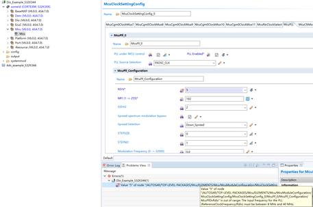

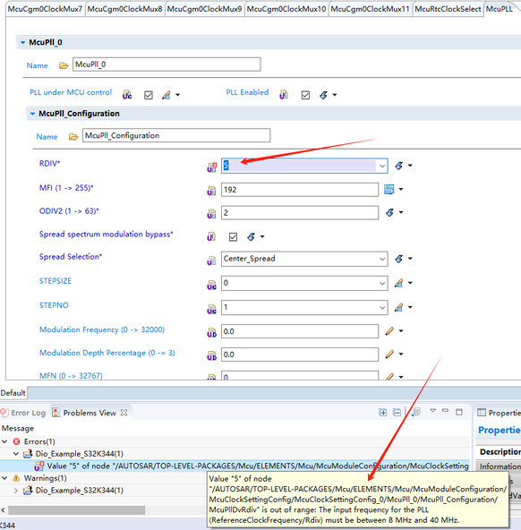

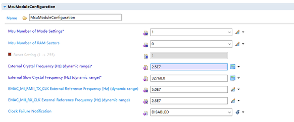

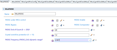

   The hardware uses a 25M passive crystal oscillator. When configuring EB tresos, it gives a clock prompt indicating that the frequency is out of range. Is this a configuration error on my part or a bug in EB tresos itself? How should I solve this problem?
It is allowed in S32DS.

Using version 6.0.0 of RTD, this error still exists.   SW32K3_S32M27x_RTD_R21-11_6.0.0_D2506

Hi @harryoceana
To rule out issues caused by missing or incorrect configurations, you can use the Im- and Exporters... in EB Tresos to import the configuration from S32DS. Please refer to the following thread for detailed steps.
Tresos computes the wrong QSPI_SFCK_CLK clock frequency
