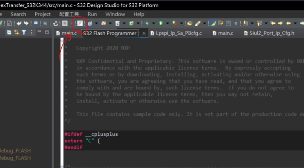

Dear Team,
How should I configure the "Flash Programmer" in S32DS to use it? My S32DS can use the Debug function to flash the program to the MCU, but the "Flash Programmer" button in the UI is grayed out and cannot be used. How can I configure it to be functional?
S32 Design Studio for S32 Platform
Version: 3.6.0
Build id: 241128

Julián_AragónM
Hi @johns_chuang,
S32 Flash Tool does not completely support S32K3 family yet. You can find the supported devices under C:\NXP\S32DS.3.6.0\S32DS\tools\S32FlashTool\doc\S32_Flash_Tool_Release_Notes.pdf
1.2. Supported devices
Flash Tool provides support for the following NXP devices:
• S32R41
• S32R45
• S32G2xx
• S32G3xx
• S32Z2/E2
Julián
