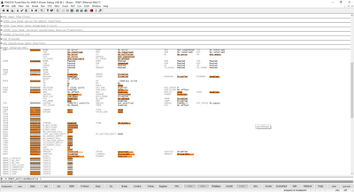

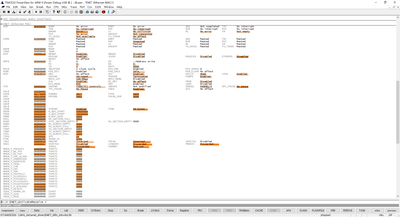

JackChen2022

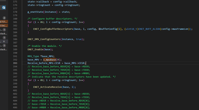

The two images are the forward and backward changes to the registers when ENET_ActivateReceive() is executed in the ENET_DRV_Init() function.

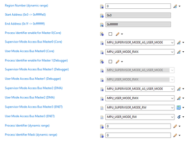

Unfortunately, I have no board to check this at the moment. But I thought that maybe your issue come from you didn't give accessing to buffer descriptor. So, my suggestion at the moment is one of them that you can try:
- Disable MPU.
- If MPU enabled, then you can configure memory region (that contains buffer descriptors of ETH) as below:
I have no SDK package, but please find in your package.

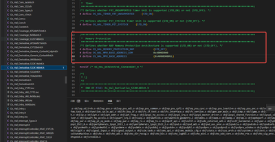

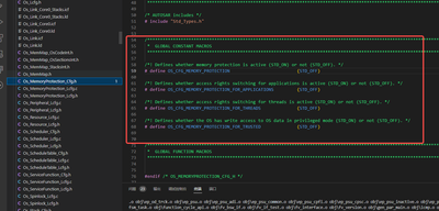

Thank you very much for your reply.

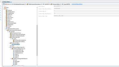

EB tool on my side does not have permission to configure OS_MPU, and I did not find the switch of disabled MPU on Da Vinci tool. The transplanted lwip protocol stack is S32SDK_S32K1xx_RTM_3.0.0 downloaded by the S32DS tool, which does not use the full Autosar tool chain, so I want to know if there is any other way to solve this problem.
I looked at the code and found that the MPU feature should be turned off.

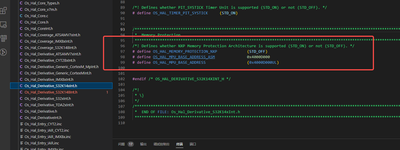

JackChen2022
Currently the debugging tool I use is Lauterbach, and MPU registers cannot be viewed.
Just now I manually add code to read the MPU_CESR register value, but it cannot be used, and an interrupt exception occurs. I don't know whether Autosar cannot read the register directly due to security requirements, or whether it needs to port the mpu_driver.c mpu_hw_access.c file to the project.

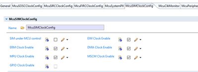

Nhi_Nguyen
Hi @JackChen2022 ,
Seem that MPU hasn't been provided clock.
Nhi_Nguyen_0-1705661351430.pngNhi_Nguyen_1-1705661359501.pngNhi_Nguyen_2-1705661367761.png
You will set value of MPU's register and don't see ??? if MPU has clock.
Nhi

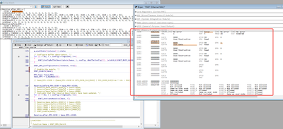

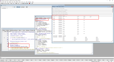

JackChen2022
Through Lauterbach debugging, it is confirmed that ECC error occurs when accessing the address of the variable rxDescriptor. What I don't understand is why this kind of problem still occurs when MPU has been disabled. Do you need to port the MPU driver in the SDK package to integrate into the Autosar project, and re-set the access rights to ENET after MPU initialization

JackChen2022
There is something wrong with the screenshot just now. I re-screenshot Lauterbach's register value to see the problem more clearly.

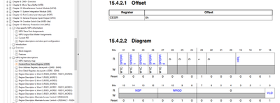

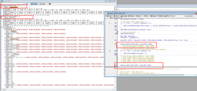

JackChen2022
Just because MPU CLOCK Enable is not set, the register value of MPU_CESR is read after enabling, and the difference is shown in the picture.
27,229 Views
Nhi_Nguyen
Hi @JackChen2022 ,
This indicated that MPU is enabled. You can try to disable MPU before initializing ENET?

JackChen2022
Ok, I ported mpc driver from S32SDK_S32K1xx_RTM_3.0.0 using MPU_DRV_Deinit() before lwip module initialization; Davinci Autosar MPU default configuration may have compatibility issues, you need to manually call the MPU_DRV_Deinit() function.

JackChen2022
After executing the ENET_ActivateReceive() function, both TDSR and RDSR are updated to 0.
Until the ENET_ActivateReceive() function is executed, the TDSR and RDSR values are normal and are the same as s_enetBases[instance].

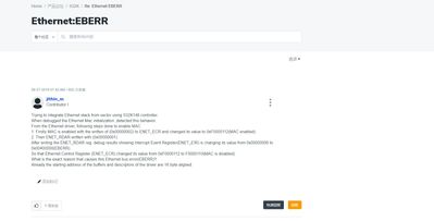

JackChen2022
I found a thread on the forum with the same problem, but had no idea how it was solved. The function has not yet reached ENET_DRV_SendFrame() and ENET_DRV_GetTransmitStatus(). After initializing the ENET_DRV_Init() function, executing the ENET_ActivateReceive() function and ENET_ActivateTransmit() results in the EBERR, register
EIR = 0x00400000,
ECR = 0xF0000110
RDSR = 0x00000000,
TDSR = 0x00000000
