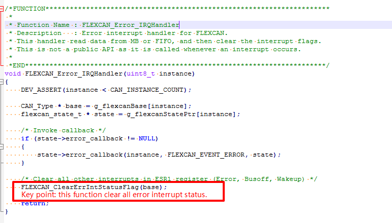

Dear support team:
I have a problem when i process the busoff event. It will lose the Busoff event process in some cases.
The main CAN interrupt process flow is showed below.
When the bus off event is occured after the condition check ((esr_reg & CAN_ESR1_BOFFINT_MASK) != 0) in the callback function, the last operation (clear all interrupt flags) will clear the busoff flag(BOFFINT: bit2 of ESR1). So when we enter the interrupt again because of the busoff event, we will find the BOFFINT bit is not set and the busoff event will not be processed.
The solution in our side is to change the last operation from <Clear all error interrupt flags> to <clear the processed error interrupt flags>. Now it works fine.

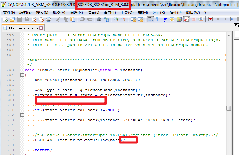

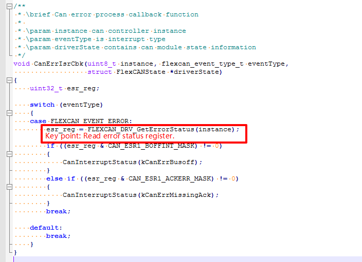

I defined a CAN error process callback function as Figure2. And i install it when system is start.
FLEXCAN_DRV_InstallErrorCallback(canHwChannel, CanErrIsrCbk, NULL);
The following is the key code.
Figure 1: Error handler in flexcan_driver.c
Figure 2: CAN error handler callback funtion
  you can imagine such a scenario:
  1. CAN bus occurred a error interrupt(eg: stuff error).
  2. The FLEXCAN_Error_IRQHandler will be executed and it will call CanErrIsrCbk.
  3. Call api FLEXCAN_DRV_GetErrorStatus to read the ESR register(Figure 2: which is marked red) and process the error event.
  4. Bus off interrupt occurred after reading the ESR and before clear ESR register(Figure 1: which is marked red).
  5. Call api FLEXCAN_ClearErrIntStatusFlag to clear all interrupt status flag.( ** Now the ESR's busoff flag is cleared ** )
  6. The FLEXCAN_Error_IRQHandler will be executed again because of the busoff interrupt.
  7. Call api FLEXCAN_DRV_GetErrorStatus to read the ESR register, the busoff flag in ESR will be zero, so the busoff event will not be processed.

To avoid this problem I suggest you to read ESR register and modify the FLEXCAN_ClearErrIntStatusFlag function to allow another parameter as mask to clear, and the Error_Handler.
Be aware that reading the ESR register can alter the content of the register from previous read by clear the status of some bits. RM : "Read this register to capture all error condition and status bits. This action clears the
respective bits that were set since the last read access."
This is way the driver was implemented by clear all condition and to user to read the status of errors to capture all the events.
void FLEXCAN_Error_IRQHandler(uint8_t instance)
DEV_ASSERT(instance < CAN_INSTANCE_COUNT);
CAN_Type * base = g_flexcanBase[instance];
flexcan_state_t * state = g_flexcanStatePtr[instance];
/* Invoke callback */
aux = read ESR;
if (state->error_callback != NULL)
state->error_callback(instance, FLEXCAN_EVENT_ERROR, state);
/* Clear all other interrupts in ESR1 register (Error, Busoff, Wakeup) */
FLEXCAN_ClearErrIntStatusFlag(base,aux);
return;
void FLEXCAN_ClearErrIntStatusFlag(CAN_Type * base, uint32_t aux)
if((base->ESR1 & FLEXCAN_ALL_INT) != 0U)
(base->ESR1) = FLEXCAN_ALL_INT&aux;
#ifdef ERRATA_E9005
/* Dummy read as a workaround for errata e9005 to ensure the flags are
cleared before continuing. */
(void)(base->ESR1);
#endif
BR,
