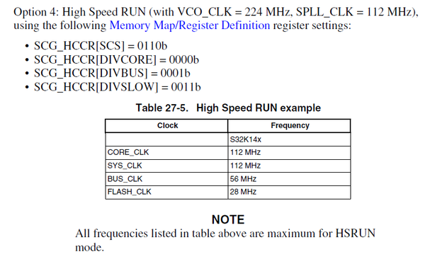

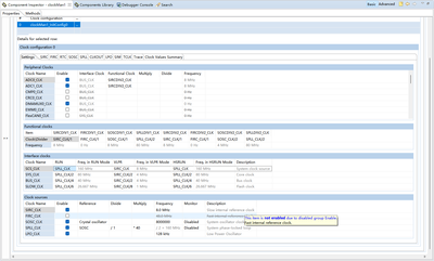

hello
I am currently optimizing a piece of code and need to increase the system frequency. What is the maximum system frequency that Love can use when S32K144 is running stably? How should I configure it? Please provide a configuration example using S32DS,
thanks
1,000 Views
Senlent
Hi@zhangchun
I see you already set the max clock for HSRUN mode and that is already the max.
Have you try set the device run in HSRUN mode?  If yes, there is nothing I can do for you.
1,011 Views
zhangchun
Currently using 80MHz, but still unable to meet the requirements
