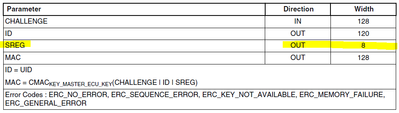

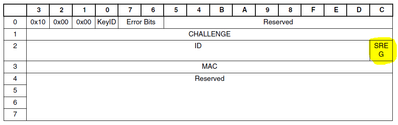

I'm trying to use CSEc module in S32K144 EVB.
In CMD_GET_ID command, there is SREG out parameter and I can't find any explanation in reference manual or AN5401.
Could you explain what SREG stands for?

SREG = Status Register. The term comes from SHE specification.
In case of CSE implementation, it's FCSESTAT register.
Lukas
