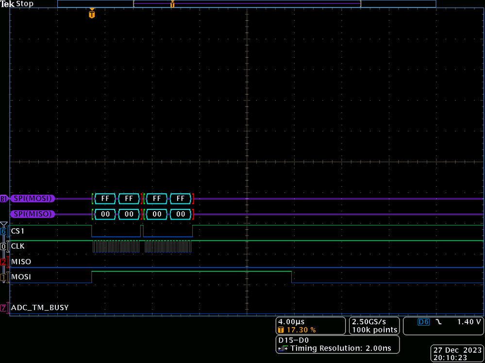

My S32K148 SPI2 peripheral was previously working but something seems to be misconfigured now.
I am communicating with an ADS8028 ADC chip.
When I try to send a write command, the MOSI line goes high and stays high, instead of sending data.

MOSI stuck highMOSI stuck high
You might think that the buffer is mistakenly filled with 0xFFFF, however I can confirm the value of (adcconf | T_SENSE) is 0x8020, and the value of (adcconf | AIN0) is 0xA000.

m_mishrikey
I was making a measurement error, and also confusing input and output.
I wish the manual used MOSI/MISO instead of SOUT/SIN, somehow that always trips me up.
Anyway, thanks for the support!!!
