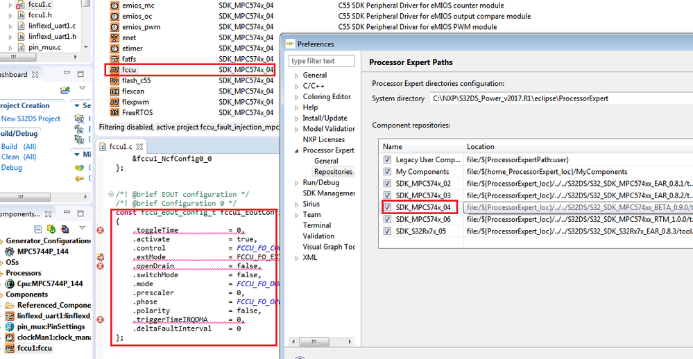

I tried to use the FCCU component in the S32 SDK v1.0.0 RTM for MPC5744P but the generated code exhibits non-existent struct members, which I would have to comment out each time in order for compilation to succeed. This issue also affects the example codes. Is there a fix for this?

As I told above, if you used driver code is v1.0.0 RTM then you must used the corresponding PEx component(SDK_MPC574x_06). Then you generate configuration for MPC5744P it will not generate the fields: toggleTime, extMode, openDrain and triggerTimeIRQDMA.
If you are using S32DS version: 2017.R1 please update SDK MPC574xx RTM 1.0.0 to be able to use the driver and PEx component corresponding: link download SDK MPC574xx RTM  REV UP5 - UP6
If you have installed  SDK MPC574xx RTM  REV UP5 - UP6 into S32 Design Studio for Power Architecture 2017.R1 then please switch workspace to an other workspace to S32DS update new software(PEx component).
Used driver code is v1.0.0 RTM and PEx component with BETA 1.9.0 - SDK_MPC574x_04 => error.
Used driver code is v1.0.0 RTM and PEx component with RTM 1.0.0 - SDK_MPC574x_06 => success.
If you have any issue please let me know.
Thank you.

I have tried the FCCU component in the S32 SDK v1.0.0 RTM for MPC5744P and did not happened issue like your issue.
If FCCU driver used is RTM v1.0.0 and PEx component used is BETA v0.9.0 then it will happen issue like your issue. More detail please check image files.
Because FCCU driver from RTM v1.0.0 then configuration structure will support features base on each derivatives. While MPC5744P derivative did not support features: toggleTime, extMode, openDrain and triggerTimeIRQDMA.
Please help me check what are you using PEx component version ?

As far as I understand, the project was created with the v1.0.0 RTM version of the SDK, so the component repository is SDK_MPC574x_04, which is the only one available to me. As you can see from the above picture, the generator configuration is set to MPC5744P so there shouldn't be any mistake there. The errors are also not contained within some #ifdef..#endif preprocessor directives so those error-causing lines get generated regardless of processor derivative.

Thank you! I didn't realize that the component version was meant to be _06! I reinstalled the update and now it compiles with no issues.
