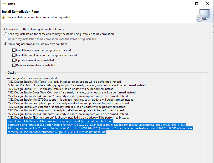

Hi @martin_kovar  ,
I'm facing same issue,
I followed the step , after clicking next button "Cannot perform operation .Computing alternate solutions." message appears. And next,
 when i try to install SDK this way, i encountered the error. Whatever i make , i didn't find any solution .
Attila

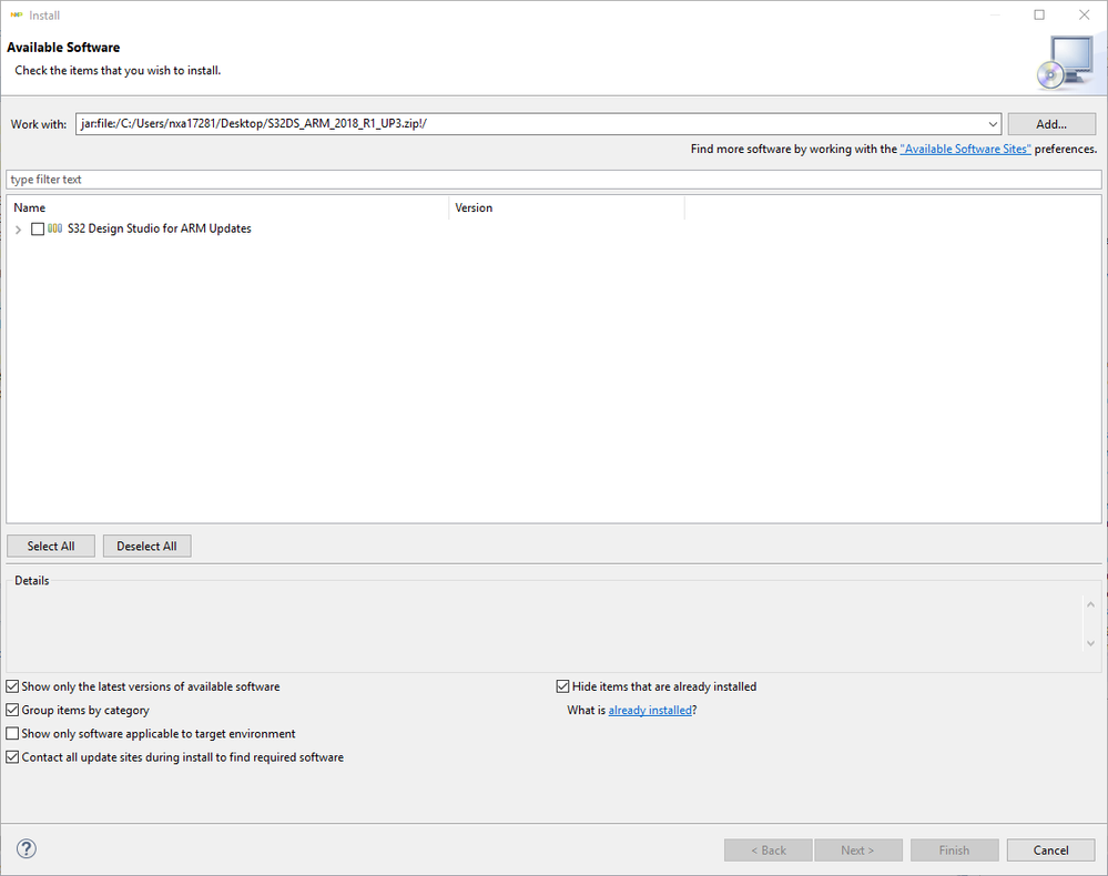

martin_kovar
SDK is not delivered standalone, but always in updates. But the update can be download from NXP website directly, please check the link below.
https://www.nxp.com/lgfiles/updates/S32DS/S32DS_ARM_v2018.R1_UP7.zip
As soon as you download the .zip file, you can insert it into Install new software window. Please see the figure below:
Martin
