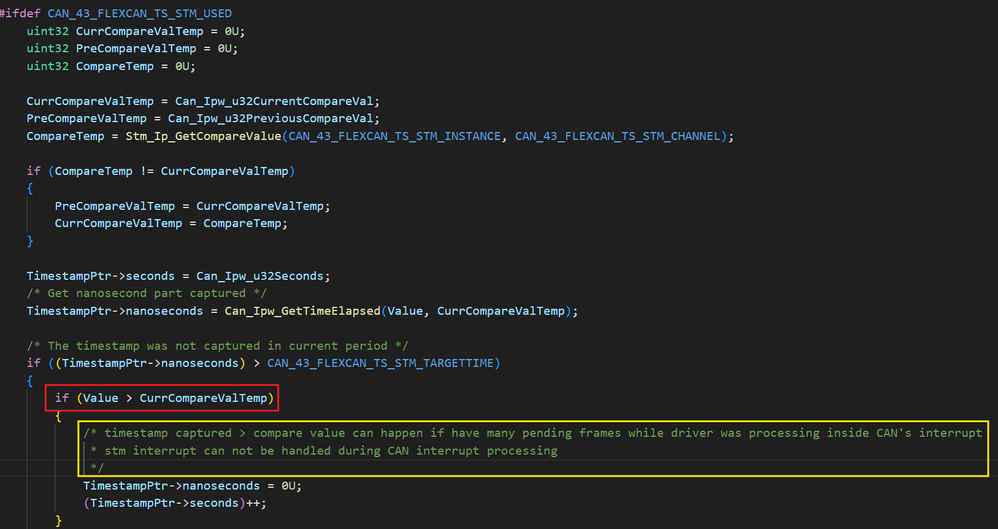

Below is the code snippet of Can_Ipw_GetTimestamp(Can_TimeStampType * TimestampPtr, uint32 Value)
Then condition in the red rectangular is occured not only in yellow rectangular situation but also in timbase overflow. TimestampPtr->seconds shall not be incremented and TimestampPtr->nanoseconds shall not be zero in the latter case.

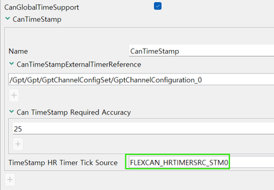

We are usinng SAF85_S32R41_RTD_0_9_0_D2207.
There is no change of the Can_Ipw_GetTimestamp in the SAF85xx_SAF86xx_S32R41_RTD_2_0_0_P03_D2404.
Please refer to the following CAN global timstamp configuration we are using.

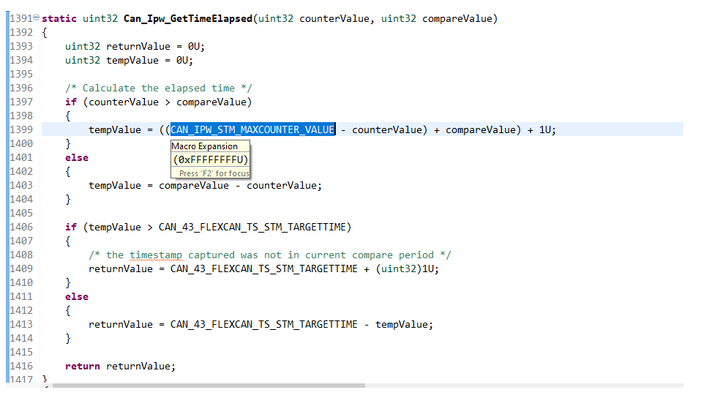

The STM counter rolls over at FFFF_FFFFh to 0000_0000h.
The driver includes the case when counter overflows. See Can_Ipw_GetTimeElapsed function for more details.

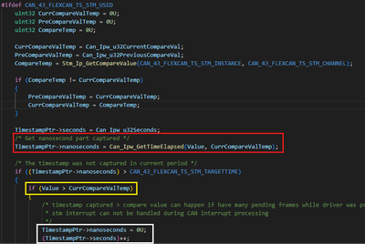

You are right. 'Can_Ipw_GetTimeElapsed' already considers the rollover of the time base so that return value of the 'Can_Ipw_GetTimeElapsed' is correct.
It means that 'TimestampPtr->nanoseonds is correct even though the rollover happens between 'Value' and 'CurrCompareValTemp' in the red rectangular of the below capture.
Let's suppose as below:
CAN_43_FLEXCAN_TS_STM_TARGETTIME = 0x2625A00 = 4000000
Value = 0xFFFFFFFA
CurrCompareValTemp = 0x2625A00
'TimestampPtr->nanoseconds' would be calculated as 0x2625A01 so that 'TimestampPtr->nanoseconds' is greater than 'CAN_43_FLEXCAN_TS_STM_TARGETTIME
In yellow rectangular, Value(0xFFFFFFFA) is greater than CurrCompareValTemp(0x2625A00). However, that's not the situation which the programmer wants. In the perspective of physical timeline which doesn't have the roll-over concept, the 'Value' does not exceed 'CurrCompareValTemp'.
Therefore, codes in white rectangular shall not be executed.
