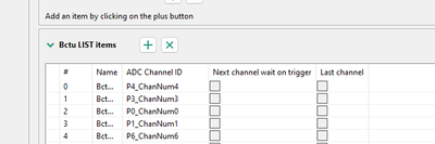

Hi Team,
I'm trying to configure ADC BCTU list configuration for hardware trigger. I need some clarification on the configuring channels in ADC0 and ADC1 instances.
For Example,
ADC0 - P0 ChanNum0
ADC1 - P0 ChanNum0
Both instances ADC0 and ADC1 has P0 ChanNum0. Please help to configure both instances with same channel number in the BCTU list.

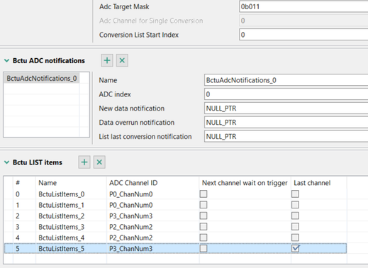

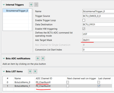

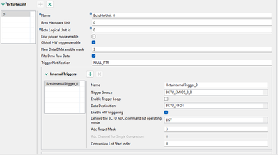

not_a_duck
your ADC target mask is correct.
but you need an entry for each channel you want to to sample for each adc.
so if you have adc 0 and 1. you target mask is 0b11 or 0x3.
if you wanted to sample ch0 ch2 and ch3. you bctu list should be.
-ch0
-ch0
-ch2
-ch2
-ch3
-ch3

Senlent
Hi@Dev15
The sequence is:
ADC0_P0->P3->P2
ADC1_P0->P2->P3

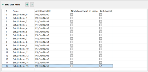

Senlent
Hi@Dev15
It's too much to list them all, below is similar as your needs.
ADC0->P0,P1,P2,P3,P4,P5,P6,P7
ADC1->P0,P1,P2,P3,P4,P5
2,132 Views
Dev15
@Senlent ,
Thank you for sharing the bctu list sequence.
I see P0 is again configured in the list with P6 and P7. Please confirm on this
2,130 Views
Senlent
Hi@Dev15
yes, please have a test first ,the ADC1-P0 will be sampled twice.
