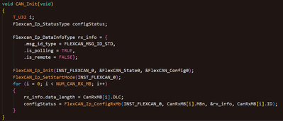

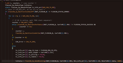

I'm trying to use the CAN as polling mode, follow my code:

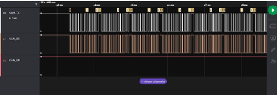

The result is TX and RX duplicated:
And the status return of "FlexCAN_Ip_SendBlocking" function is "FLEXAN_STATUS_TIMEOUT":

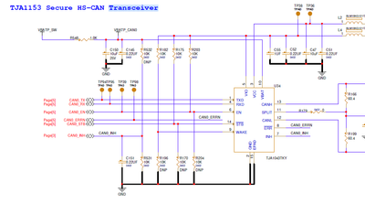

PetrS
from a description it could be that a transceiver is TJA1153, which needs a config first. But Q172 in last revision is populated with normal TJA1043. Maybe some earlier board version have that secure CAN transceiver. So first check a board version and also read transceiver's top marking.

PetrS
seems FlexCAN is repeating a message due to missing ACK from other node.
Do you have other node connected configured for a same CAN bitrate and sample time?
BR, Petr

PetrS
yes, it is due to that fact. Message is not successfully transmitted without error detected (missing ACK), so it is repeating automatically, and using blocking function you got timeout status.

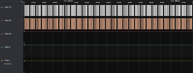

I put the another device on the other side of the transceiver but I still have the same problem... I also measured the CAN_H and CAN_L signals but there are no signals... 

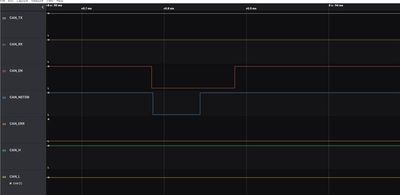

@PetrS ,
Today I tested more things. I think that the problem is with transceiver, what do you think?
I have tried to set the EN and STDB_N as HIGH, following the datasheet, but I always see the ERR_PIN with LOW level. I have tried to test with examples available on NXP community and in the IDE but doesn't work. Follow one print about the configuration (The ERR_PIN doesn't change the level):
I have tried to set as much as NORMAL MODE as COLD START, but without success. I tried put another device sending message in CAN_H / CAN_L  but I can't see signal in CAN_RX.
It occur the same when I send message via NXP microcontroller using the line CAN_TX, the signal is duplicated like shown earlier. And the ERR_PIN always is LOW.

3,638 Views
wuxianlong
Contributor V
The transceiver is TJA1153 and needs to be configured.

@wuxianlong @PetrS Nice, thanks for help!
I was able to do it works. I followed this forum:
https://community.nxp.com/t5/S32K/S32K344-EVB-With-EB-AUTOSAR/m-p/1351864#M12367
And the board is using the TJA1153. So summarizing, I changed the clock and send some data over CAN to initialization, besides setup EN and NSTB as well.
