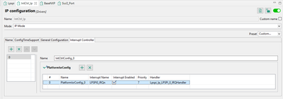

I am having difficulties in finding the lpspi transfer mode selection.
S32K312EVB-Q172 evaluation board which uses S32K344 is being used.
I used Lpspi driver LSPI3 and did the configuration but unable to find, How to change the transfer mode selection settings.
In the generated code LPSPI_IP_POLLING is selected i needed LPSPI_IP_INTERRUPT.
Any inputs on this would be of help.
Thanks in advance.

I apologize for the inconveniences; it seems there is currently no way to enable interrupts from the SPI driver's peripheral perspective. I will report this problem with the corresponding team.
"Master" mode supports both asynchronous methods (DMA & Interrupts).
You will need to configure the IntCtrl driver for an interrupt name and handler, as implemented in the HalfDuplex examples:
It is also important to update the transfer mode with the following line:
    Lpspi_Ip_UpdateTransferMode(SLAVE_EXTERNAL_DEVICE.Instance, LPSPI_IP_INTERRUPT);

We have configure the IntCtrl driver for an interrupt name and handler.
and will try using the function for updating the transfer mode.
