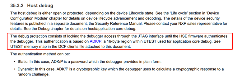

Could you please let me know process how to lock/unlock JTAG/Debug port via software with password for S32K342 micro controller.
2,976 Views
petervlna
Could you please let me know how to program the DCF record and Life cycle state?
The DCF records are programmed to UTEST flash.
For DCF please refer to Chapter 37 Device Configuration Format (DCF) records of reference manual
For Life cycle to chapter 32.5.2 Address LC configuration word
Is it directly through application programming or through JTAG scripts we need to lock/unlock?
You can use both. For more details please refer to chapter 32.5.2 Address LC configuration word.
Could you please direct to me if we have any application notes related to this topic.
There is no application note directly for LC. In case you are not using HSE, then it is directly trough IVT, like 32.5.2 express.
In case of HSE, then it is trough HSE services.

3,041 Views
petervlna
You simply program DCF record (Debug password(CUST_DB_PSWD_A)) in UTEST memory and advance life cycle
or in case you have HSE FW installed:
