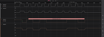

During my test, it has a high possibility that the I2C slave will keep low after receive message from the master. Only reinit the I2C slave can recover.
Below image is the LA measurement, I think it is an OK waveform so it probably not a circuit issue.

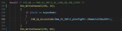

Hi @acnhyxgxl1,
It looks like this function is called only if AsyncMode == FALSE.
How did you configure the INFLS driver?

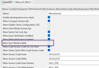

1,199 次查看
acnhyxgxl1
My original setting was using async mode, but sync mode can also do my task.
I've tried both sync / async mode in Mem43_Infls, however it seems like only Async mode can write the data to flash correctly.
In Sync mode, although `Mem_43_INFLS_Write` returns `E_OK`, the content of Flash wasn't change(monitor via S32DS memory interface).
The sync mode also couldn't solve this I2C issue. The I2C slave will held low whenever the I2C command triggered Flash erase.
The attachment is my mex file and my flash HAL source code. Maybe you can provide me some clues.

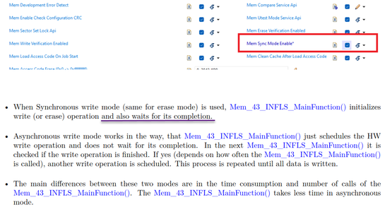

Hi @acnhyxgxl1,
Refer to RTD_MEM_43_INFLS_UM.pdf that is located in the installation directory of the RTD.
In SYNC mode, the driver blocks the I2C bus while waiting for the flash operation to complete.
BR, Daniel

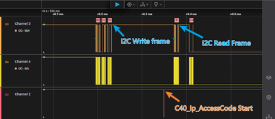

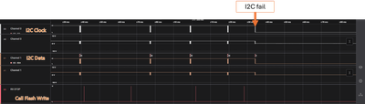

acnhyxgxl1
I found that when the Flash is processing `C40_Ip_AccessCode(Mem_43_INFLS_pConfigPtr->MemAcCallBackPtr);` in `Mem_43_INFLS_IPW_Erase` and the I2C Slave is waiting for the read frame will cause I2C slave failure.
Is ther any countermeasure to solve this issue?
