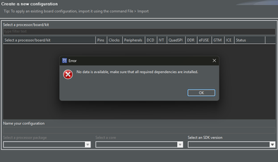

Hello!

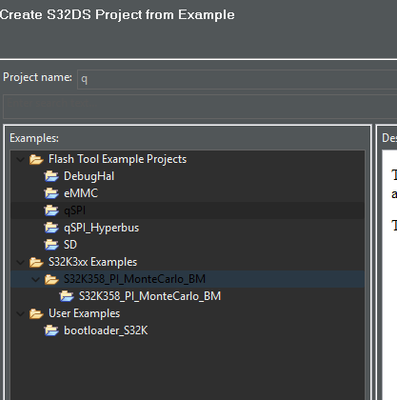

My problem is that S32K1XX SDK installation does not install to S32DS. Either trying to open any example project or opening S32 Configuration Tools none of the SDKs have been detected. Just to illustrate how empty everything is:

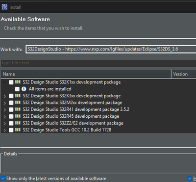

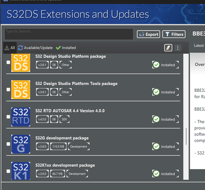

I have installed S32K1XX SDK from the Help -> S32DS Extensions and Updates:
As well as Help -> Install new software
Furthermore I have downloaded and installed S32_SDK_S32K1xx_RTM_4.0.2 for external use but it does not seem to help and I have yet not been able to add it to S32DS.
Could somebody help to get this environment up and running for S32K144? Currently I am out of ideas on how to work with this processor.

Hi @r-j1
Based on the images you shared, it appears that no software has been installed for S32K1 devices.
Download and install the Real-Time Drivers (RTDs) for S32K1 devices. These can be found  in Automotive SW - S32K1_S32M24x - Real-Time Drivers for Cortex-M section under Real-Time Drivers for S32K1. Specifically, you need to download the DesignStudio_updatesite.zip file. For example, S32K1_S32M24X Real Time Drivers AUTOSAR R21-11 Version 3.0.0 → SW32K1_S32M24x_RTD_R21-11_3.0.0_D2503_DesignStudio_updatesite.zip.
After downloading, install it through S32DS Extensions and Updates by selecting Add Update Sites.
Regarding the S32_SDK_S32K1xx_RTM_4.0.2, please note that it is only included in the S32 Design Studio 3.4 S32K1xx Service Pack 1. Therefore, it will not be compatible with or supported by S32DS 3.6.
BR, VaneB

r-j1
I managed to fix it with updatesite and updating S32DS enviroment to the latest version (see VaneB comment on this topic). Also when making a new project see that the GCC version for the project and the GCC version for the SDK would be the same, otherwise it will not turn up.
