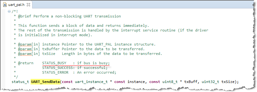

hello, SDK.
When I use the following statement, the uart cannot emit any data.But SDK routines do support this.When I add "while(UART_GetTransmitStatus(&uart1_pal_instance, &bytesRemaining) == STATUS_BUSY)" at the end of the statement, the UART can send data as normal.How to solve this problem?
UART_SendData(&uart1_pal_instance, sendbuf, size);
Labels (2)
2,667 Views
Robin_Shen
Hi 张 舜毅,
Your method is correct.
UART_GetTransmitStatus returns whether the previous transmission has finished.
Have you check the status of UART_SendData? If it return STATUS_BUSY?
It is not recommend to call UART_SendData regularly, without check whether the previous transmission has finished.
Robin
