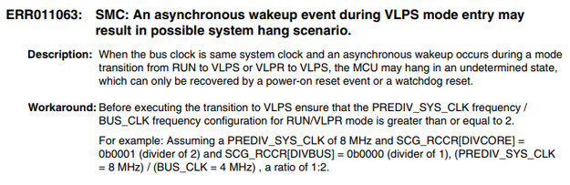

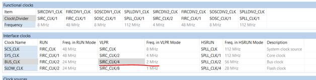

Senlent
Hi@john24
please have a try the below methods.
