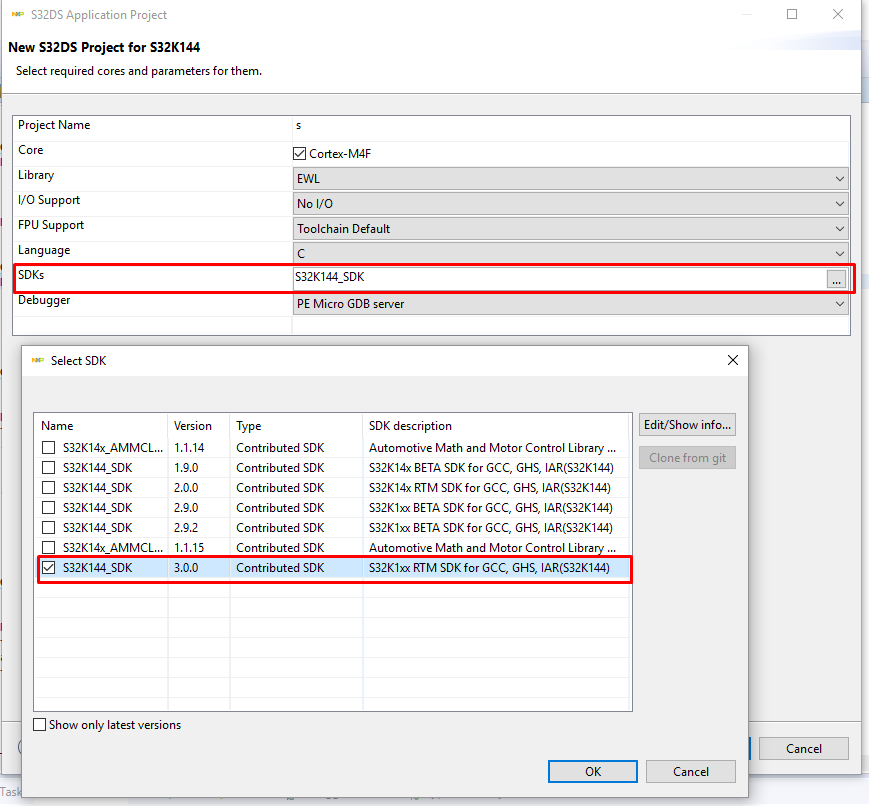

Also, I took the opportunity to update S32DS, to get the new SDK version, since it's now a RTM version. Next step would be updating project properties, to use the new SDK, right?
Do you have any hints about how to do it?
Joao

dianabatrlova
Hello Joao,
I would like to apologize for the delay.
Yes, with a slower clock source will be lower power consumption.
When you want to use new SDK version in the project the fastest way is to create a new application project and there choose the newest SDK version.
I hope it helps.
Diana
