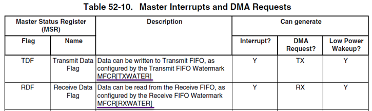

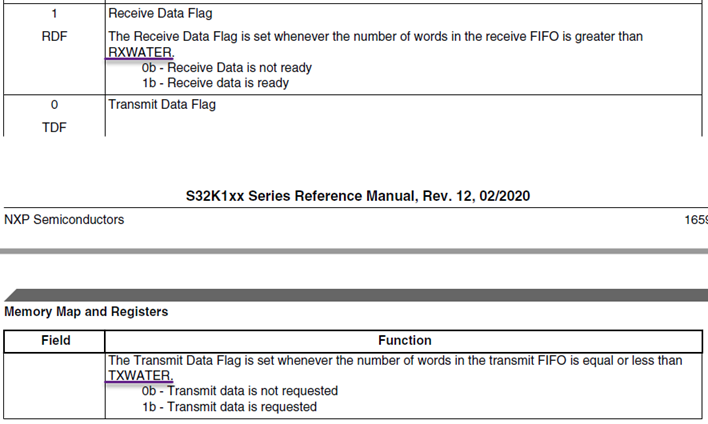

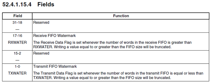

In the S32K144 datasheet, about the I2C module, there is a register: MFCR.
Can you explain the register application?
Thank you!
1,056 Views
danielmartynek
Hello wanglijun,
As explained in the reference manual, the register basically defines when the Receive/Transmit Data flags are set.
