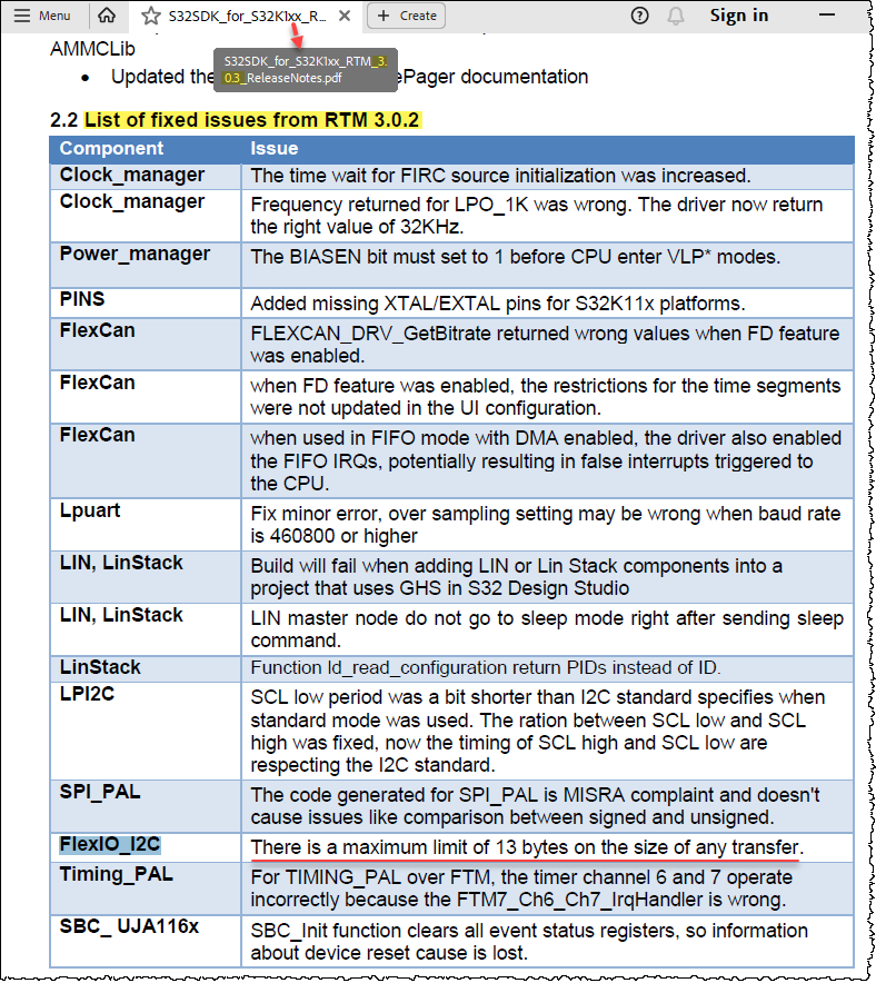

Our communication protocol follows: for each master request, the slave should respond with 15 bytes.
But we understood that FLEXIO Master Receive will support only up to 13 bytes; if it is more than 13 bytes, it is getting asserted.

Hi Sundar,
Please update the S32K1 SDK to RTM 3.0.3 or higher. It was fixed in RTM3.0.3, read S32SDK_for_S32K1xx_RTM_3.0.3_ReleaseNotes.pdf
FlexIO_I2C There is a maximum limit of 13 bytes on the size of any transfer S32SDK_for_S32K1xx_RTM_3.0.3_ReleaseNotes.png
