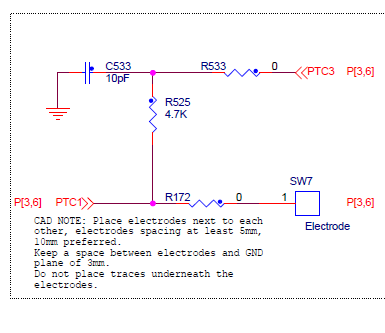

Hello All,
I'm working in S32K144 MCU for the FlexCAN Communication. I have used the Example Source NON-SDK for FlexCAN, EVB Board flashed the example and tap the CAN_TX Line(PTE5) to the scope and Running the programming can see the CAN Frame Data.
My problems are,
I'm using PTC3 -CAN_TX(ALT3) and PTC2-CAN_RX(ALT3) followed the same Example code only different is PORTC changed.
Please anyone faces the same problem with using PORT C for FlexCAN0
Port C Configuration,
Case 1:
PCC->PCCn[PCC_PORTC_INDEX ]|=PCC_PCCn_CGC_MASK; /* Enable clock for PORTC */
PORTC->PCR[3]|=PORT_PCR_MUX(3); /* Port C3: MUX = ALT3,(CAN0)C_CAN TX */
PORTC->PCR[2]|=PORT_PCR_MUX(3); /* Port C2: MUX = ALT3,(CAN0)C_CAN RX */
Case 2:
PORTC->PCR[3] &= ~(PORT_PCR_MUX_MASK);
PORTC->PCR[2] &= ~(PORT_PCR_MUX_MASK);
Both Case 1 and Case2 i'm not see any Data signls with the scope.
Please let me know if any other configuration required.

razva_tilimpea
Hi all,
I suppose that both of you are using S32K144 devkit.
On that board PTC3 is not connected to pin headers because it is by default connected to touch electrodes.
For more details about schematic please go to :S32K144 Evaluation Board|NXP  and download S32K144 Quick Start Package.
Razvan
