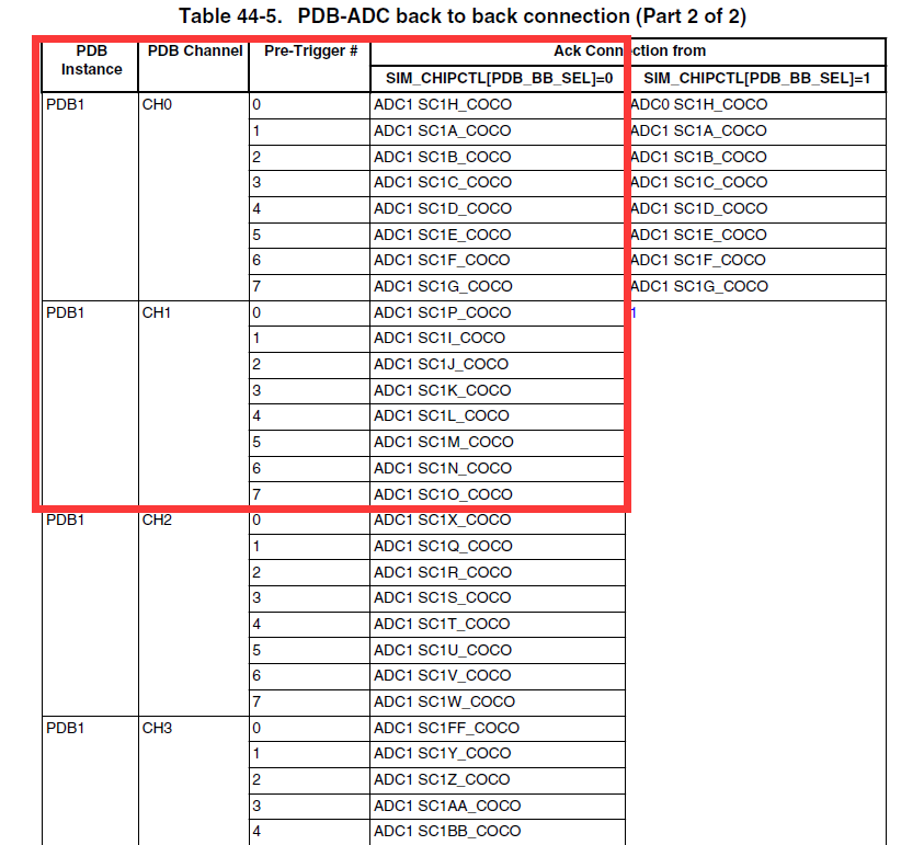

My application needs are: ADC1 uses 12 channels. Use the PDB1 trigger and store the results of the ADC acquisition via DMA.
At present, I trigger the 8 channels of ADC1 through channel0 of PDB1, and want to send the remaining 4 channels through the channel1 channel of PDB1.

PDB_DRV_SetAdcPreTriggerDelayValue(PDB_INSTANCE, 0UL, 0UL,(uint32_t) delayValue);
PDB_DRV_SetAdcPreTriggerDelayValue(PDB_INSTANCE, 1UL, 0UL,(uint32_t) (60000));

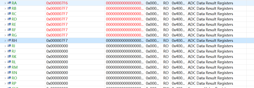

In my program,The first trigger time of channel 1 has to be after the last measurement of PDB channel 0.(I don't know how much time should be set at a specific time) .When entering the DMA interrupt, only the 8 channels triggered by PDB1 channel0 have data.I didn't locate the reason:

PetrS
see attached main.c I modified in your ADC_DMA_test-master project. Now all 12 conversions are done and DMA properly transfer it from ADC to buffer variable.
I made few changes:
- fix DMA setup to properly read ADC result registers and transfer value to buffer variable
- ADC channels 0-11 must be used according to PDB pretriggers selected
- PDB1 chn delay0 must be properly set. I used ch0 delay0 = 0 and ch1 delay0 = delayValue/2.
delayValue was calculated to set PBD modulo 1sec.
Timing can be adjusted based on ADC conversion timing, which is discussed in the chapter 42.5.4.5 of the RM.
