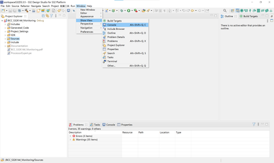

Zyuan17
Hi, I took your advice and it seems like the SDK works. But I can't find the components' window now. I have checked the window->view and there is no component window option.
