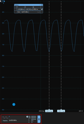

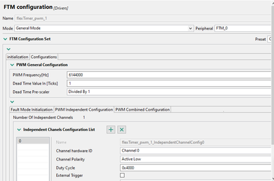

I want to generate frequency of 6.144MHz with 50% duty cycle. For that I tried using FTM_PWM but it is giving delta on output. I entered 6.144MHz in configurator but output side it is giving 6.4MHz.I want to over come this delta and need pure frequency.
Please share sample code or configured code for this requirement.
I don't want to generate frequency on CLKOUT pin.I attached configuration and output screenshot.

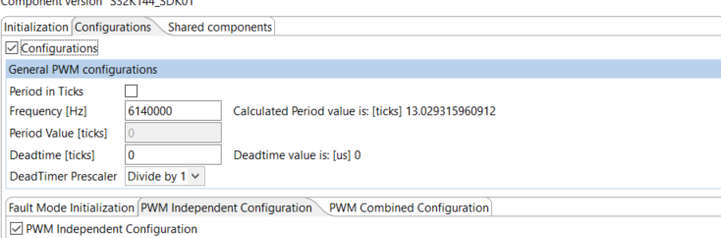

Senlent
Hi@Mohit_Manvar
This is expected and this is not a problem with your software.
For example, if the FTM module clock is 80MHz, you can see that if you need to output 6.14Mhz PWM, you need to set it to 13.029315960912tick, but in fact you can only set it to 13 ticks

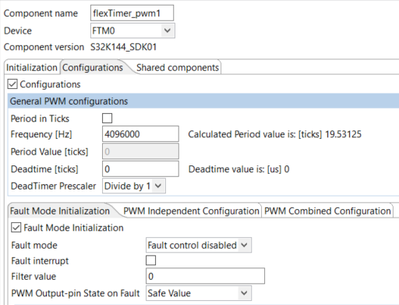

Senlent
Hi@Mohit_Manvar
ticks = FTM_SOURCE_CLOCK / Expected output frequency
for example:FTM SOURCE CLOCK is 80MHz, expected output frequency is 4.096Mhz
ticks = 80Mhz / 4.096Mhz = 19.53125 ticks.
