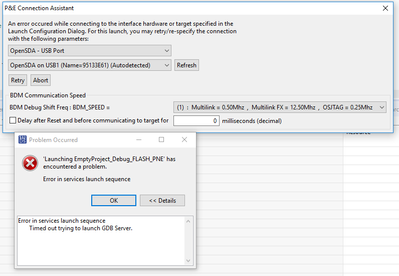

Dear Officer,
We had a SK32K118 EVB board working fine previous, then after playing around with the "CAN bootloader" project then suddenly we are not able to connect with the board via "OpenSDA Embedded -USB Port". (We will always jump to P&E assistant popup then failed on connection.)
After searching around, it seems some memory has been corrupted? And how can we recover from this case? Any method to performa a entire re-falsh the chip?
Tks and best regards
He Wei

Hello He Wei,
Can you share the PrintScreen of the failure?
Can you tell me the state of LED D1 located on the board?
Please, restart S32DS/PC and try to create a new empty project and select the option below in the debug configuration.
Diana

Dear Diana,
1). The error print is:
2) LED D1 is always off. (Further, D2 and D3 will be On if selecting 3.3V but D3 will be off if selecting 5V)
3) I create a empty S32K118 project and select the option as you recommend, the same error appear.
4) Further, also we connected with a multilink device and try the "USB Multilink-USB port" option but got same error too.
Please advise.
He Wei

When powered through USB, LEDs D2 and D3 should light green, also, in the case of selecting 5V.
Can you, please, measure VDD_MCU whether the MCU is powered (in both cases)?
Can you share the last project which you loaded into MCU and S32DS version? (I can try to reproduce your issue)
Thank you.

Dear Diana,
We measured VDD_MCU and it always LOW (0 Vol) no matter powered from USB (5V or 3V) or external 12V, it shows the MCU itself could be permanently damaged.
He Wei
