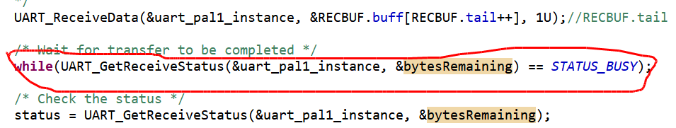

I used a ring buffer and didn't want to wait for the receive to finish. I found something wrong when I skipped this code. What's the matter? What's the solution.
1,571 Views
victorjimenez
The function UART_ReceiveData performs a non-blocking receive, this means that if you don't wait you will interrupt the receiving process which will end up in a problem. If you don't want to wait, I recommend you using the receive interrupt of the UART.
