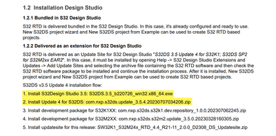

This depends in your development route and needs, but if you are planning to use S32K1 ISELED AUTOSAR R21-11, you will need to install S32K1 RTD + S32DS 3.5. You can find this information inside the release notes for the SW:
S32K1 ISELED Release notes
ISELED driver uses RTD 2.0.0 P04, which in consequence uses S32 Design Studio 3.5 & update 4 for S32DS:
S32K1 RTD Release notes
